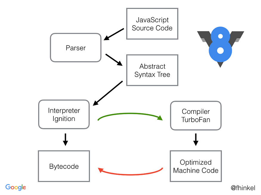

const image = document.createElement('img')
image.className = 'my_image'
image.src = 'https://miro.medium.com/max/875/1*ZIH_wjqDfZn6NRKsDi9mvA.png'
image.alt = "V8's compiler pipeline"
image.width = 480
document.body.append(image)
log(document.images[0]) // .my_image
